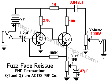

Here's the schematics of a couple of the variations of the Arbiter Fuzz Face Reissue, with changes highlighted in red:
![Arbiter Fuzz Face Reissue Schematic](fuzzface/fuzzfacereissueschematicB.gif)
It's impossible to draw a conclusion as to which version is "better" than the other, because some
people like the Silicon versions, and some people don't. It is safe to say, however, that the Silicon versions will
obviously be free of one major problem that plagued the Germanium Fuzz Faces...temperature instability. It's been
noted many times over that if they get too hot...they'll stop working. It was also much easier to produce more
consistent sounds from unit to unit with the Silicon versions (whether those "sounds" were good or not was left for
the purchaser of pedal to decide). A problem with Silicon transistors that doesn't seem to exist with Germanium is
that they can have too much gain. Too much gain will cause a Fuzz Face to sound horrid. With Silicon it becomes very
difficult to stick with the Q1 hfe of 70 and Q2 hfe of 120, because most Silicon transistors are way over 120 to
begin with. Someone in Aron's Stompbox Forum said that placing a 100pF capacitor across the Collector-Base junction
of the transistors in a Silicon Fuzz Face clone would help control the gain and oscillation, so if you decide to
build this version, keep that in mind.

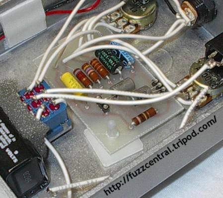

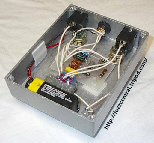

There has been a lot of controversy about the value of using carbon composition resistors in a
circuit when you're trying to clone the sound of a vintage effect pedal. But for my Fuzz Face clone, I've decided to
build it as accurately as possible, which means using as many NOS parts as I can get my hands on, and when they're
not available, using new production parts that can reproduce the values of the originals. The 1/2-watt carbon comp.
resistors are available from Mouser, although these are 5% tolerance instead of the 10% that the original circuit
used, but this simply means that the value of the resistors will be closer to the desired resistance. I also had
quite a time finding 20µF axial lead electrolytics, but after looking through the Mouser catalog, I discovered that
they do indeed stock 20µF/25V Sprague Atom capacitors, which will be perfect. For the 0.01uF capacitor I'll be using
an original-type flat, metallized polyester film with axial leads. Locating the right transistors for this circuit
could also prove to be a problem, but luckily I have some SK-series Germanium transistors that are just right. I
also soldered a 2M2 input pulldown resistor to the underside of the circuit board to prevent it from popping with
true bypass.
![Arbiter Fuzz Face](fuzzface/tnfuzzface1.jpg)
![Arbiter Fuzz Face](fuzzface/tnfuzzface2.jpg)
