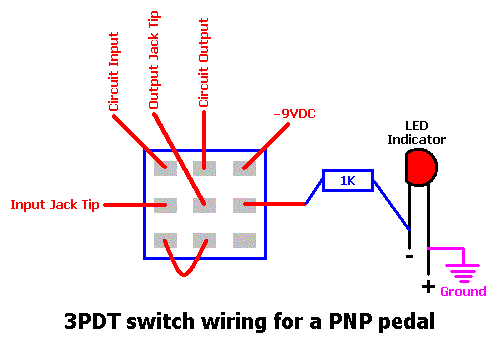

Stomp Switch Wiring
Here are some diagrams of how the stomp switches are wired up for true bypass. I've included three diagrams...the 3PDT with LED indicator for NPN, 3PDT with LED indicator for PNP, and DPDT with no LED indicator.
Switch Wiring
NPN 3PDT Wiring
Switch Wiring
PNP 3PDT Wiring
Switch Wiring
NPN & PNP DPDT Wiring

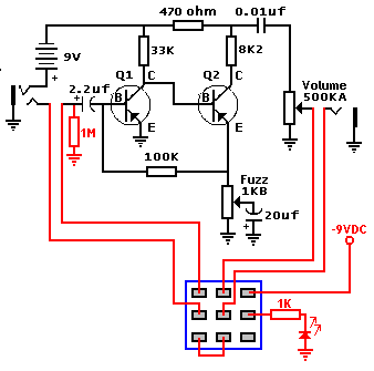

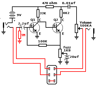

Complete Circuit Stomp Switch Wiring
Below are a couple of examples of how the schematics on the site would look if the stomp switch were drawn into them, in this case the 3PDT with a LED indicator, and a DPDT with no LED indicator. I've provided examples for the NPN and PNP versions of the Fuzz Face, but the examples would be correct for all the other schematics too. The DPDT switch can be wired the same way for NPN or PNP.
Switch Wiring
NPN Complete Circuit 3PDT Wiring
Switch Wiring
PNP Complete Circuit 3PDT Wiring
Switch Wiring
Complete Circuit DPDT Wiring

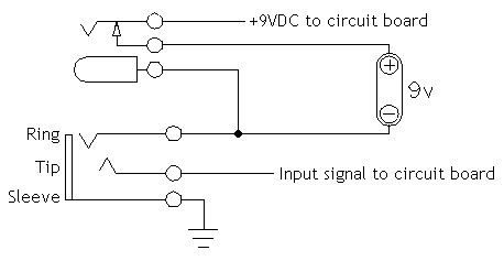

Wiring for Input Jack Battery and Power Switching
Here's a little diagram that shows how to wire the power switching setup on a pedal using a stereo input jack, a 9V battery clip, and a power adapter jack with an internal switch (like the one listed on all of my pedal parts lists). Make a note that this diagram is for negative ground pedals, and WILL NOT work for positive ground PNP pedals. The polarity of the power adapter jack tip is positive outside, negative center.
Power Wiring
Input Jack, Battery, and Adapter jack wiring.

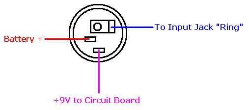

DC Adapter Jack Wiring
Below is a diagram that shows how to correctly wire the DC power jack that I use on my pedals (see the project parts lists for the Mouser part number...). This wiring diagram will only work for NPN negative ground pedals. It will NOT work for PNP positive ground pedals.
Power Jack Wiring
Power Jack Wiring.
