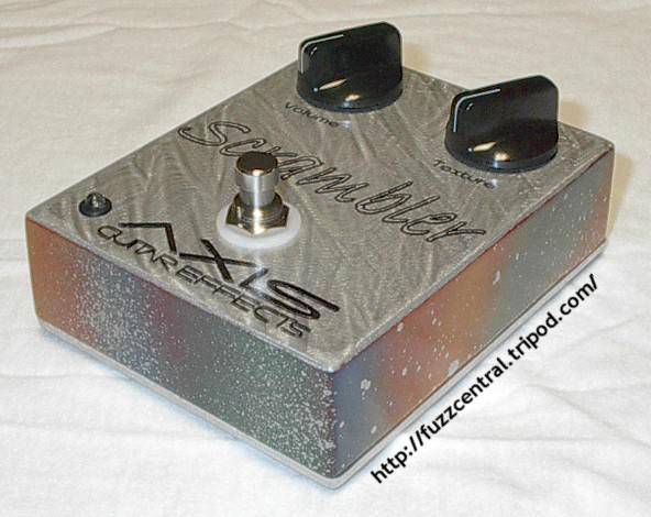

Ampeg Scrambler
This is the clone of the very rare Ampeg Scrambler, which was built in very small numbers back in
the late 60s. Originals are very rare these days and sell of outrageously high prices when one does become available,
similar to the Tycobrahe Octavia. Guess what? I love this thing! This pedal is everything that I expected it to be
and more! It does a great raspy fuzz like the fOXX Tone Machine, but it can be gradually blended in with the clean
guitar signal.

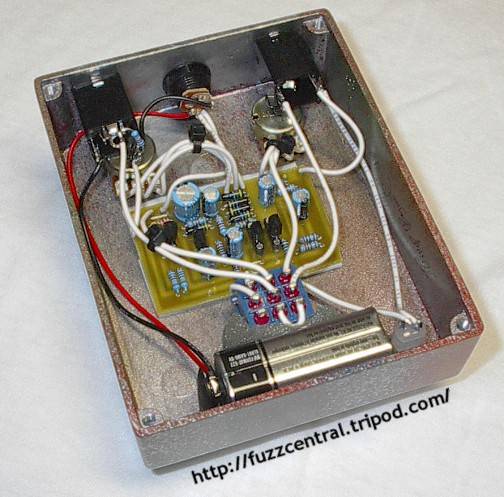

On this one I used the original type 2N5306 NPN darlington transistors just like the original used. Watch out for
these though because the pinout is different! (See the illustration below for the correct pinout.) I also used the
original type diodes, the 1N456. I installed all 5 of them, but I've heard that you can leave some of them out
without any sonic impact. The switch is a 3PDT switch that I got from Steve Daniels, and I also used little socket
to hook the wires up to the LED for a much cleaner appearance, not to mention being easier to install.

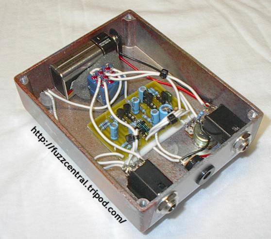

Below are some pictures of my Ampeg Scrambler clone. Click for the full-size image. Use your browser's
"Back" button to return to this page.
