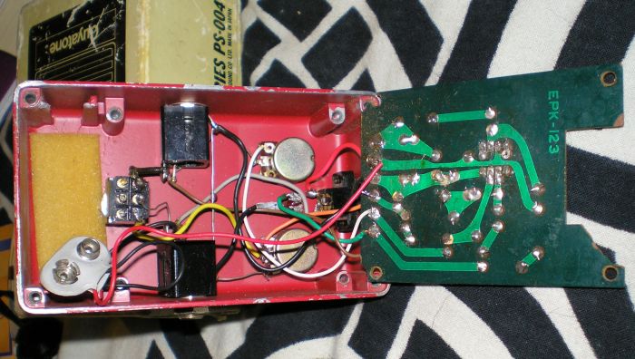

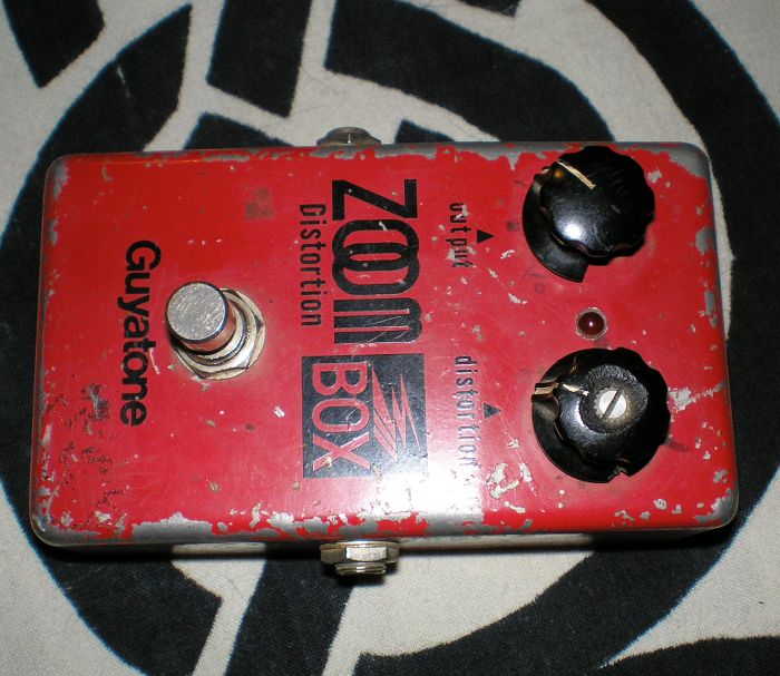

Guyatone Zoom Distortion from Colin
"Guyatone zoom distortion found at a car boot sale last weekend. Pictures are as bought, I've not had time to re-wire it properly yet. Pot values are measured as
there is nothing on them. I presume they are both log."

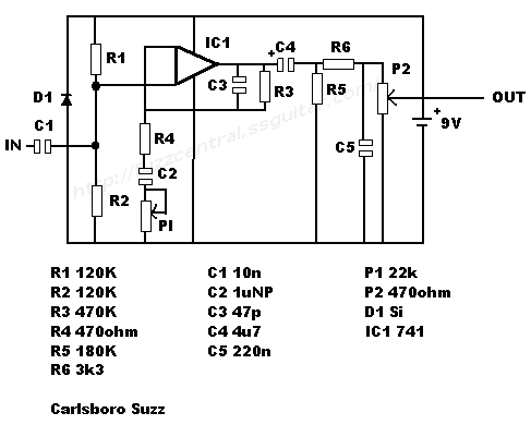

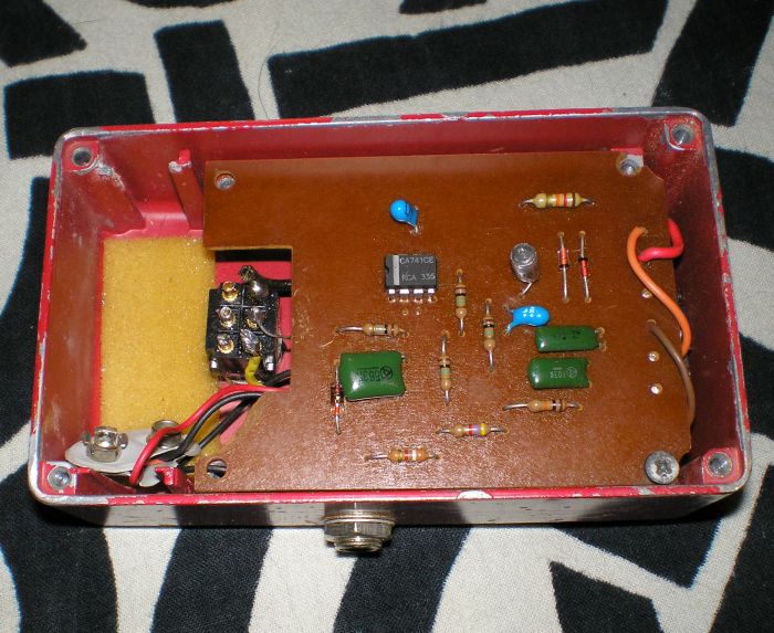

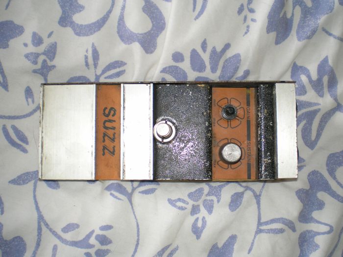

Carlsboro Suzz from Colin
"I also found the attached pedal (Carlsboro Suzz) in bits and restored it. I had the plastic boxed version in the 80's but can't remember if the circuit was the same. Not very
exciting but it is a punk classic!"

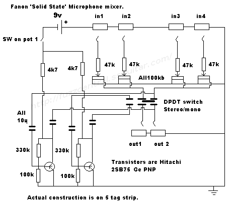

Germanium Mic Mixer from Colin
"You might be interested in this which I recently repaired. It's not a pedal but it's a useful microphone mixer that uses Ge transistors, a 9v
battery and would be easy to clone. The original was built on a 5 tag stripboard with the centre as earth. It took me some time to work it all out a the original
out connectors had been replaced with jack sockets and it had been very poorly wired. The resistors are huge carbon comp types. No hiss though!"
