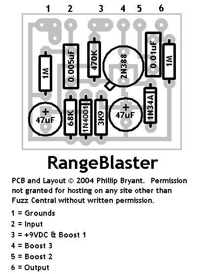

it uses a Germanium transistor instead of Silicon transistors that modern-design boosters use. I used a NPN Germanium
transistor (2N388A) instead of a PNP so that I can use a negative ground so that I can use the same power supply as
all my other effects. My also version incorporates some modifications that are intended to improve it's sound and to
possibly prolong it's lifespan. I have added a reverse-biased Germanium diode between the base-emitter junction of
the transistor to offset the effects of temperature variation on the transistor (this modification is outlined in the
"Britface" article on the Plate-to-Plate site).
The second modificiation is a 1N4001 diode in parallel with the power
supply to protect the circuit from any accidental reverse bias that may occur. I also added 1M resistors to the input
and output to prevent popping with my true bypass arrangement. As RG said in his article about the RangeMaster, you
REALLY need to use 1% metal-film resistors for this circuit because they are less prone to noise...and this thing will
amplify hiss and hum and anything else that happens to find its way in. You also need a WELL REGULATED power supply
to get rid of that 60-cycle hum or you will have a very noisy circuit.

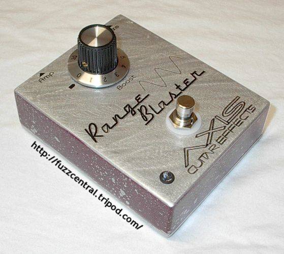

Below is the schematic of my modified version of the Rangemaster...the RangeBlaster!

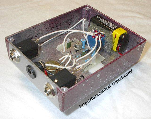

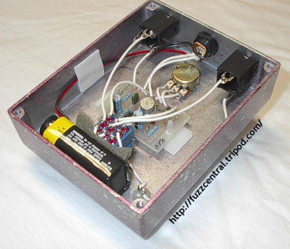

Below are some pitures of a RangeBlaster that I build for Kurt. Click the thumbnails for the full-size picture! Use your browser's
"Back" button to return to this page.

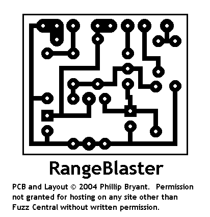

Note: These files are NOT to be used in a pedal that you are building for profit. The PCB file is
copyrighted artwork and is subject to a licensing fee.
Dallas Rangemaster PCB
Dallas Rangemaster Layout
Dallas Rangemaster Parts List
Build Difficulty: Easy
RangeBlaster PCB
RangeBlaster Layout
RangeBlaster Parts List
