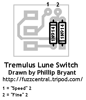

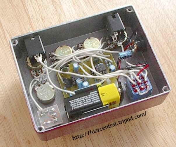

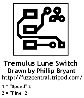

I also made a little circuit board to mount to the bottom of the switch, which also holds the two 1N914A diodes. I thought
that this made the construction a lot cleaner and neater. This design also uses the LED/LDR combo to couple the LFO to the
input and ouput stages. I mounted the rectangular LED so that its face was right up against the LDR, and wrapped a small
piece of black electrical tape around them so that no stray light would find its way in.

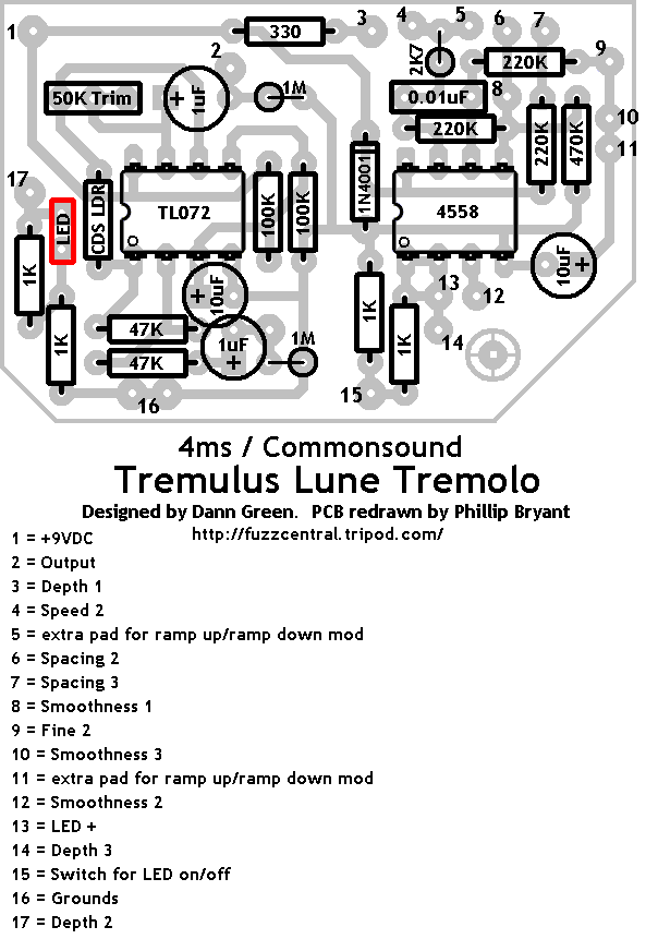

After I finished shoehorning the circuit board, pots, switches and jacks into a 1590BB box, I plugged it in for the first time,
I had to set the trimpot so that the output level of the tremolo was at unity, but if you so desired, you could set it so that
the output was a little higer than unity for more volume boost. The first thing that I noticed was a loud "popping" as the LFO
cycled. After looking through the Commonsound tweaking guide for the Tremulus Lune (available on the Tremulus Lune page of the Commonsound site...see
the links below in the 'Project Files' section below) and following the directions therein, I soldered a 0.001µF
capacitor across the trimpot and added a 100µF capacitor from V+ to ground. These two simple additions to the circuit
completely solved the problem, leaving me with the best tremolo on the planet! On a scale of 1 - 10, with 10 being the best, I

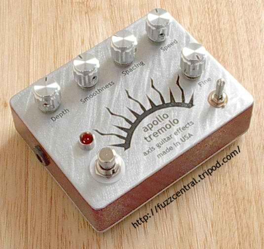

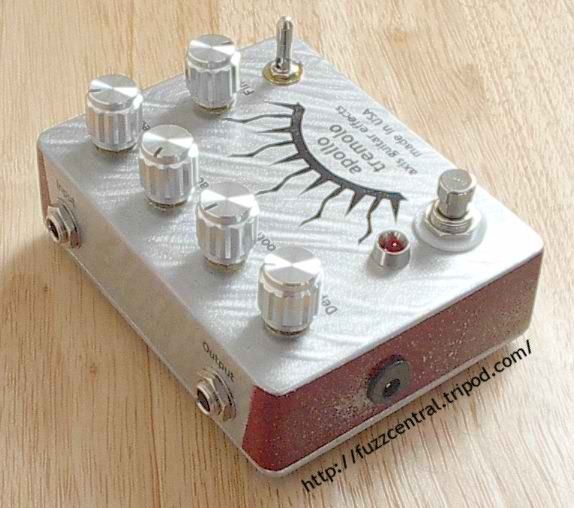

And here are some pictures of my Tremulus Lune, which I called the "Apollo" with an especially neat rising sun decal on
the top of the box. Click the thumbnails for the full-sized image:

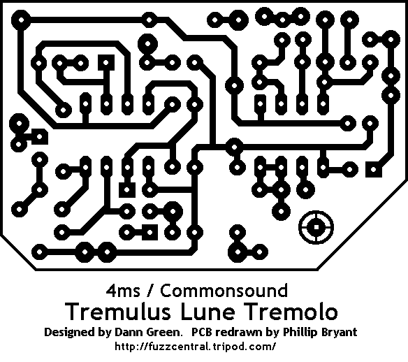

4ms Tremulus Lune PCB
4ms Tremulus Lune Layout
4ms Tremulus Lune Parts List (for my build)
Switch-Mounted Circuit Board PCB
Switch-Mounted Circuit Board Layout
