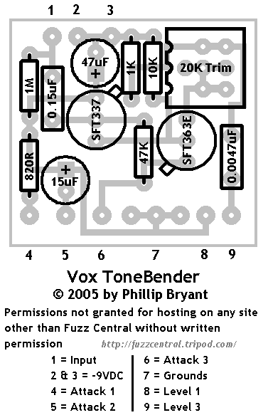

Below is a picture of the circuit board in a Vox ToneBender with SFT337 and SFT363E transistors. I've also seen a Vox ToneBender circuit
board with a SFT337 for Q1 and an OC76 for Q2.

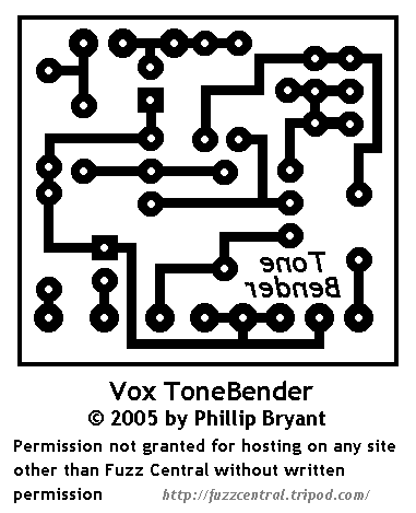

Note: These files are NOT to be used in a pedal that you are building for profit. The PCB file is
copyrighted artwork and is subject to a licensing fee.
Vox ToneBender PCB
Vox ToneBender Layout
Vox ToneBender Parts List
Build Difficulty: Easy
Above the is the PCB, Layout and parts list that can be used to build the Vox ToneBender. I have replaced
the 8K2 resistor on the collector of Q2 with a 20K trimpot so that you can adjust the voltage on Q2's collector to -4.5VDC, which
will give the best overall sound. A 1M input pulldown resistor has been added to the circuit board so that you can use true bypass
switching without the "pop" caused by a leaky input capacitor. I've also added a 47µF capacitor to the circuit for power supply
filtering. This capacitor is optional, but recommended because it will help remove additional hum and hiss. The trimpot mod is not
shown on the schematic above, but the input pulldown resistor and power supply filtering capacitor are highlighted in blue.
